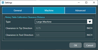

NC Server Settings Dialog Box - Machine Tab
NC Server application Settings dialog box - Machine tab
Option
Description
Type check box
This defines the type of machine you want to configure in NC Server. You can select from these options in the list:
  • Large Machine
  • Small Machine
  • Custom
Clearance in Tip Direction check box
NC Server uses the value you type in to define the tip clearance in the tip's direction.
Clearance in Tool Direction
NC Server uses the value you type in to define the tool clearance in the tool's direction.
