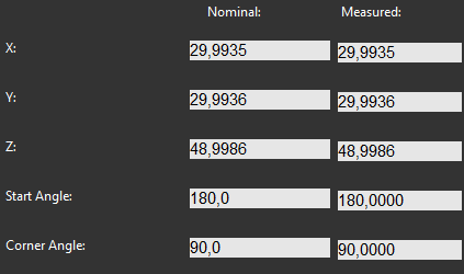

NC Gage takes four points starting with the first point on the first side and ending with the second point on the second side to locate the inside corner.
NC Gage then measures the four points and calculates the intersection point of the two sides.
7
Review the measured values on screen and if necessary, adjust the nominal values.
8
Press OK to add the command to the measurement program.
