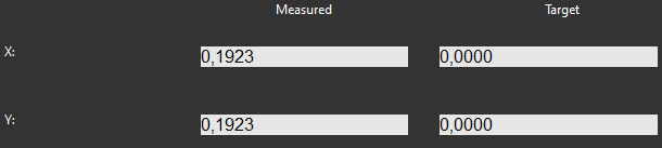

8
Review the measured values on screen and set the desired target values for the offset.
9
Press OK to set the selected work offset.
